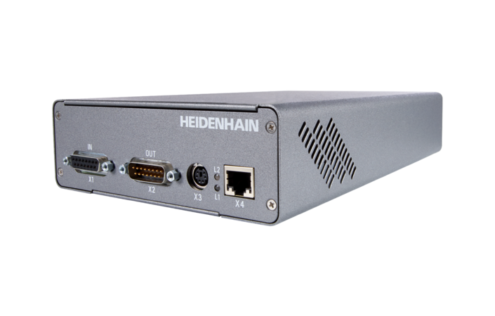

Inspection unit for diagnostics and adjustment of absolute and incremental HEIDENHAIN encoders
  • Functional testing
  • Mounting wizard
  • Calibration capability
  • Adjustment via ATS software
  • Online diagnostics with the EnDat interface
  • USB port for connecting to a PC
  • Connectivity of EnDat 3 (E30-R2) encoders to the PWM 21 via the SA 1210 signal adapter
Diagnostics directly on the encoder
The encoder is connected directly to the inspection device. This enables a comprehensive functional analysis of the HEIDENHAIN encoder.
Adjusting and testing software
The ATS adjusting and testing software with integrated local encoder database enables automatic encoder identification.
Diagnostics in the control loop
The PWM inspection device is linked into the closed control loop. This makes real-time diagnostics of the encoder possible in the machine or multi-machine system during operation. The functions depend on the interface.
Software options
The ATS adjusting and testing software can be expanded by additional functions, such as a datum shift with information display, by purchasing a product key.
