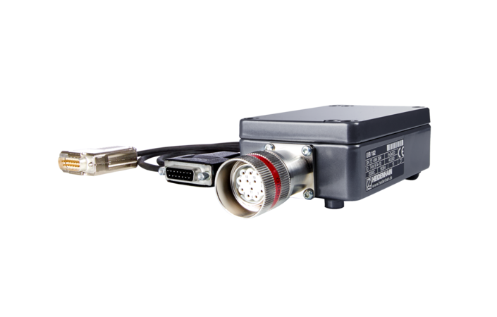

EIB 100 and EIB 3000 series
Signal converters with incremental interface at input and serial interface at output
  • Input: incremental HEIDENHAIN encoders with 1 VPP interface
  • Output: EnDat 2.2, Fanuc Serial Interface, Mitsubishi high speed serial interface
  • Different design options: connector version and robust housing version
  • Integrated subdivision: 16 384-fold
Online diagnostics
Support for the online diagnostics of EnDat 2.2, with output of the valuation numbers for the incremental track. These numbers reflect the current status of the encoder and determine an encoder's function reserves.
Built for long-term operation
The interpolation and digitizing electronics of the EIB 100 series can handle harsh daily shopfloor conditions thanks to a dust-proof, water-resistant housing design with an IP65 rating.
