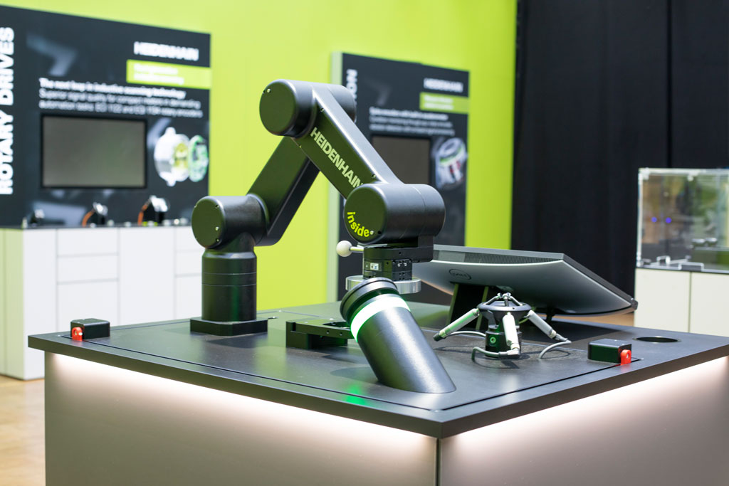

At SPS 2024, a cobot demo unit with secondary encoders from the HEIDENHAIN GROUP will be demonstrating this force measurement functionality. By watching a force gauge, observers can witness how the robot stays within defined force thresholds and how it switches off automatically when the exerted force exceeds 100 Nm, the critical limit for collisions between cobots and the human torso.

High accuracy and collision monitoring without additional torque sensors: A demo unit at the HEIDENHAIN booth will be demonstrating the benefits of secondary encoders for cobots.
