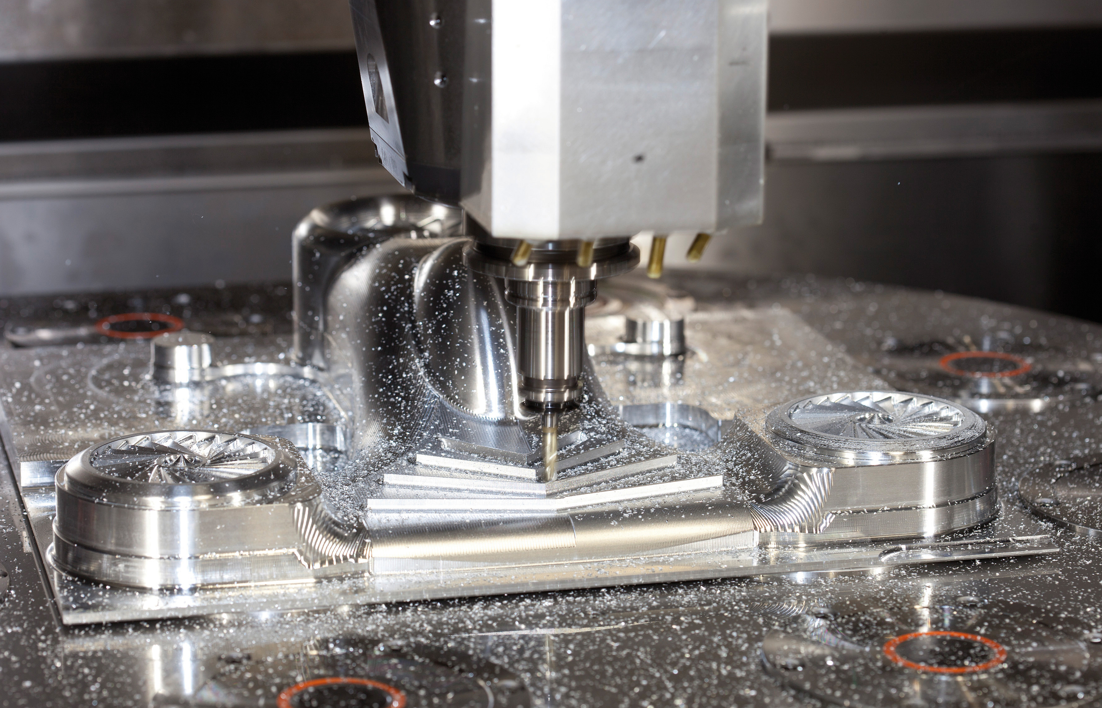

Delivering high dimensional accuracy, optimal surface quality, and stable production processes, the TNC7 select offers the cutting strategies and software options needed for high-performance 5-axis machining: gantry support, numerous connectivity functions, and KinematicsOpt for refining the kinematic model.
Advanced 5-axis machining
The TNC7 select provides high dynamic performance, extreme precision, and state-of-the-art user guidance for machines made primarily for precise, high-productivity 5-axis simultaneous machining. Machine manufacturers benefit from an optimally scalable platform from the TNC7 family of CNC controls.

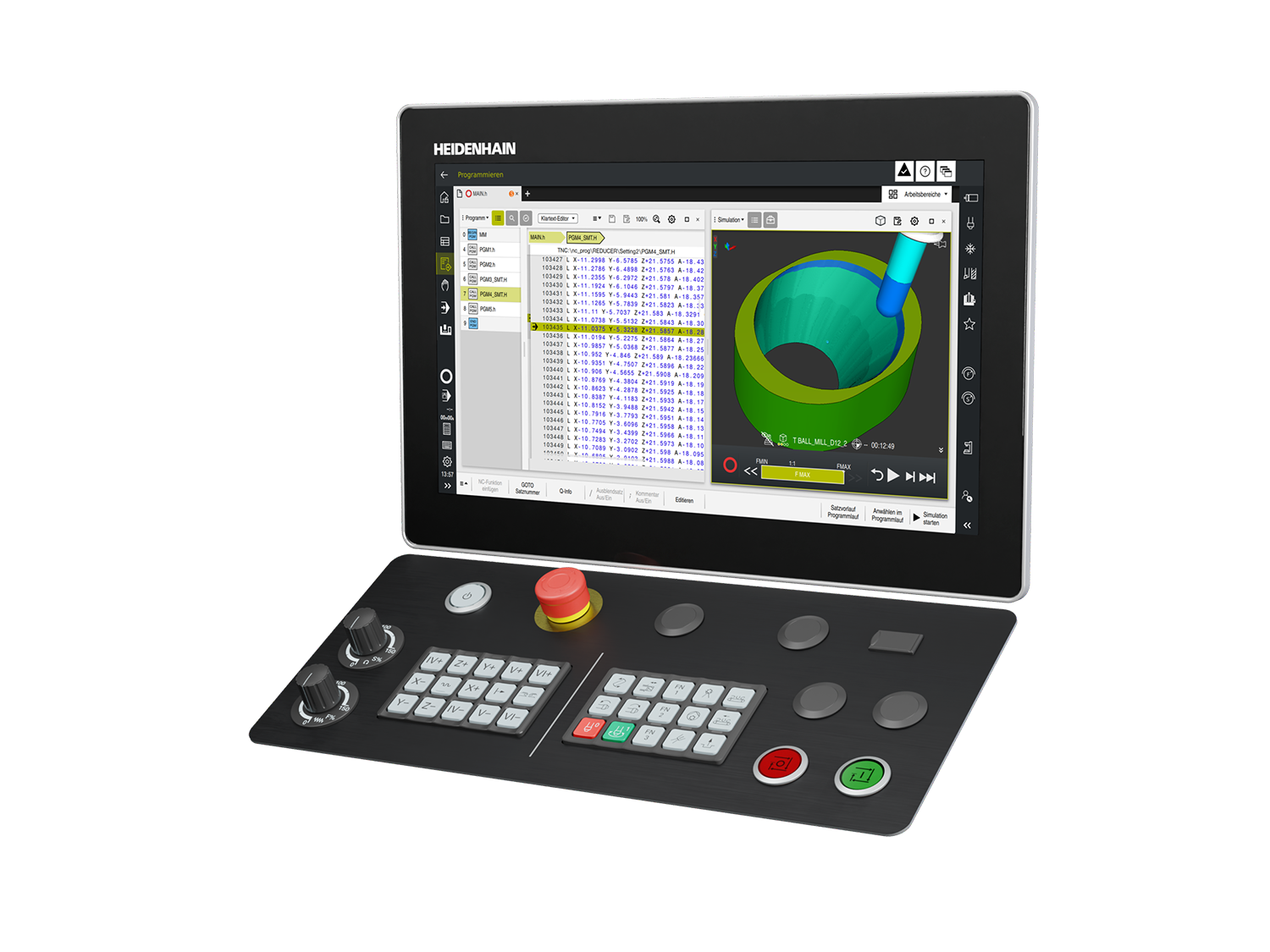

Compact operating layout
Featuring 16-inch operating panel hardware, the TNC7 select enables compact machine designs and ergonomic, space-saving workstations. Machine operators are provided with a state-of-the-art TNC7 user interface, featuring fast response times and an intuitive layout that simplifies daily operation and shortens the learning curve.

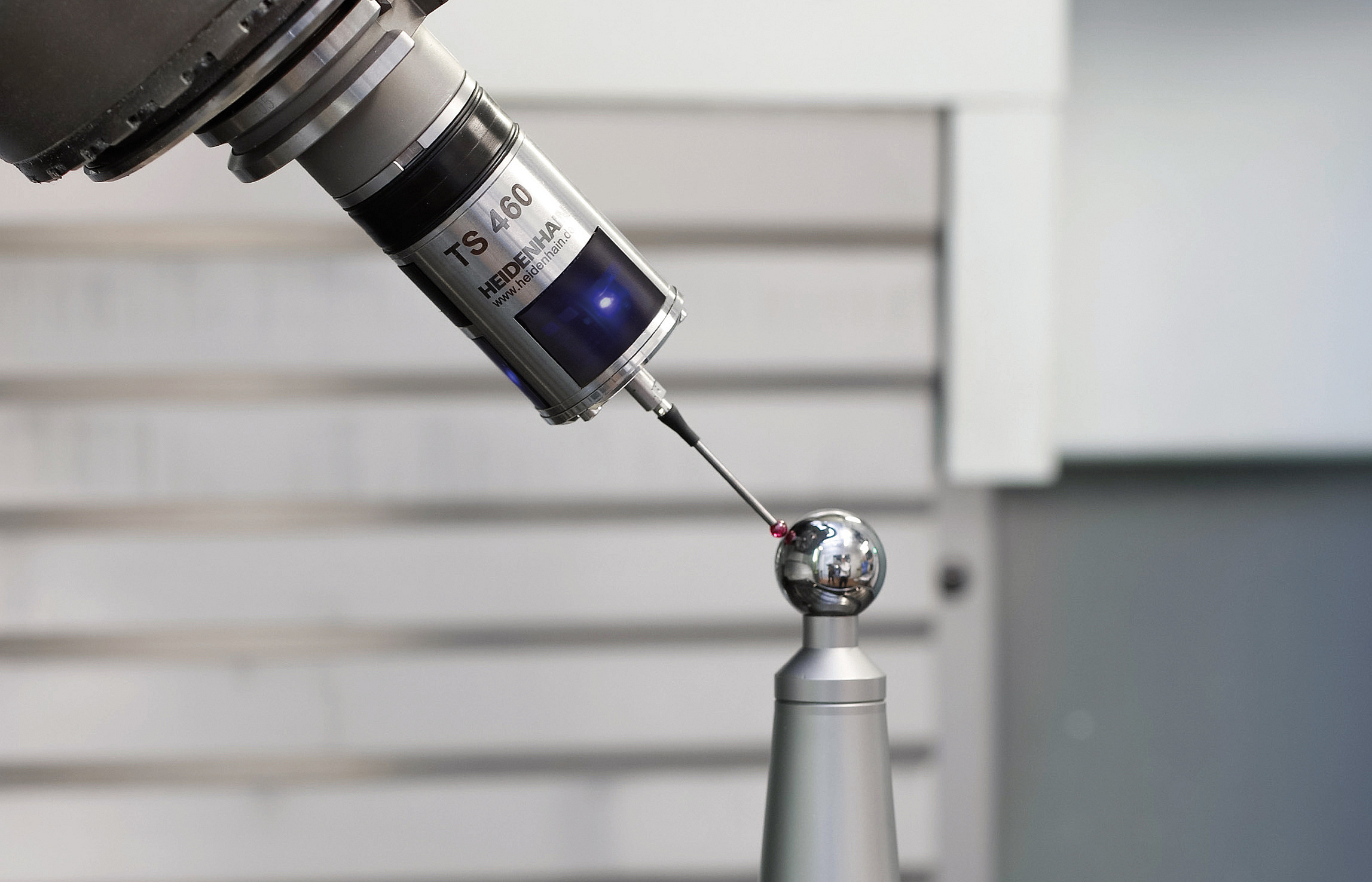

Optimize the kinematic model
With KinematicsOpt, the control can correct for position errors in rotary axes, thereby increasing accuracy during tilting operations and simultaneous machining. Repeated measurements and corrections even allow temperature-dependent deviations to be offset. The rotary axes are measured with a calibration sphere that is attached to the machine table and probed with a HEIDENHAIN touch probe. Users define the desired pattern of measuring points and a measurement range for each rotary axis beforehand.
