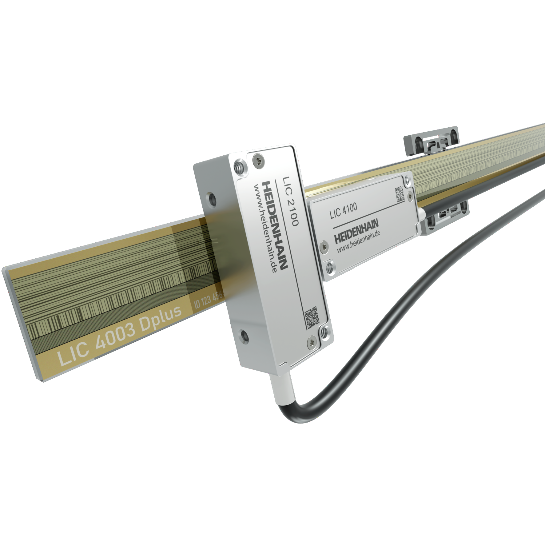

LIC 4100 Dplus series
Absolute linear encoder with graduation tracks at 0° and 90°
  • For high-accuracy, fast-travel linear axes
  • Main measuring length: up to 3040 mm
  • Secondary measuring length: ±0.5 mm
  • Variant with a very small measuring step down to 1 nm
  • High speed and position stability
  • Standard scanning heads from the LIC 4100 and LIC 2100 encoders
  • Interfaces: EnDat, Fanuc, Mitsubishi, Panasonic, and Yaskawa
Multidimensional measurement
The Dplus encoders from HEIDENHAIN provide feedback for multiple degrees of freedom along a single axis. This technology allows errors in one axis to be measured and compensated for in a neighboring one.
High travel speeds
LIC linear encoders stay accurate at very high travel speeds. Measuring steps of down to 1 nm at up to 600 m/mm are possible. High contamination immunity makes their absolute position feedback exceptionally reliable.
Innovative graduation structures
The graduation carrier of this encoder contains two separate, orthogonally aligned graduation tracks. Feedback for the second direction of motion can thereby be obtained along the entire measuring length.
Multiple degrees of freedom
With two scanning heads and the two separate graduation tracks of a Dplus encoder, feedback in up to three degrees of freedom is possible within a compact form factor, thereby simplifying complex measurement challenges.
Resistant to contamination
A large scanning field makes these encoders highly resistant to contamination. Contamination on the measuring standard has only a minimal effect on signal quality. Reliable feedback is therefore ensured.
Flexible integration
The LIC 4100 Dplus absolute encoder uses two conventional scanning heads from the LIC 4100 and LIC 2100 encoder series, thus connecting with EnDat, Fanuc, Mitsubishi, Panasonic, and Yaskawa interfaces.
Exposed linear encoders consist of a measuring standard and two scanning heads. Please select these components from the lists. For further advisory support, please contact our Sales department by phone or e-mail, or use our contact form.
Measuring standard
Please select an AK LIC 41x scanning head for the main direction of measurement and an AK LC 21x scanning head for the secondary direction of measurement.
