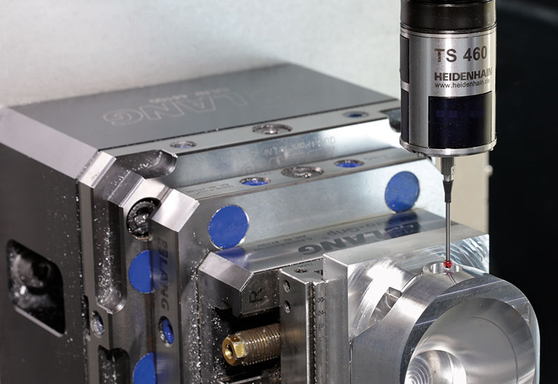

TS 460 and TS 760 from HEIDENHAIN: gain productive time
Quicker and in-process setup and measurement of workpieces: this is made possible by the TS 460 workpiece touch probe from HEIDENHAIN, with its very high measurement feed rates of up to 3000 mm/min. The time saved during probing, which can be as great as 30%, then becomes available to machinists as valuable productive time on the shop floor. The integrated flusher/blower unit of the TS 460 provides for high measurement accuracy, since it cleans any chips from the probing surface that would otherwise falsify the measurement result. And, the probe can optionally be equipped with an effective anti-collision buffer that not only prevents expensive damage but also decouples the touch probe thermally. The TS 760 touch probe from HEIDENHAIN enables workpiece measurement with particularly high 3D accuracy and very low probing forces. This makes it ideal for precision parts in moldmaking and highly sensitive workpieces. Its measurement feed rates of up to 1000 mm/min ensure a high level of performance.

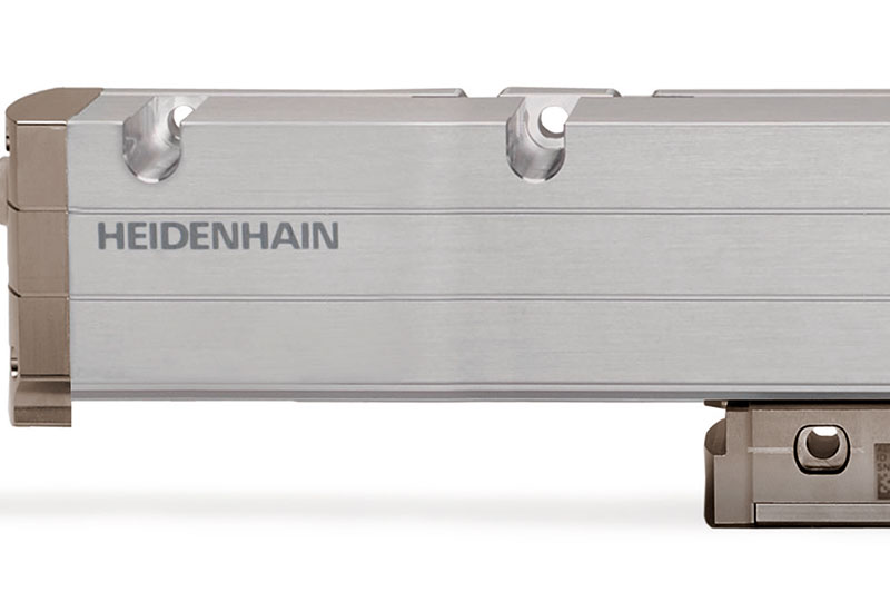

The LB 383 C from HEIDENHAIN: the new scale for long axes
The LB 383 C sealed linear encoder from HEIDENHAIN is the new specialist for position measurement on machines with long axes. It is available in measuring lengths of up to 72 m. Thanks to its sturdy scanning unit, the new LB 383 C is particularly tolerant to contamination and at the same time very rigid in the measuring direction. This increases process reliability and permits significantly more powerful controller parameters, resulting in better machine performance. The LB 383 C also saves money, since its profiles are adapted to those of the LC 200 linear encoders. This not only reduces the amount of stock you need, but also obviates the need for special connecting pieces for compressed air.
