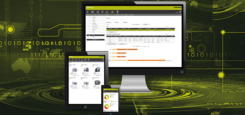

StateMonitor and PlantMonitor: collect, analyze and visualize machine data
The StateMonitor software gives manufacturers real-time insight into the production status of their CNC machines. StateMonitor collects, analyzes and visualizes machine data, allowing users to run perfect analyses of machine statuses, tool data, NC program durations, PLC signals and other machine-related data. This information can then be used to uncover optimization potential. Here are the new features due to appear in the fall of 2022:

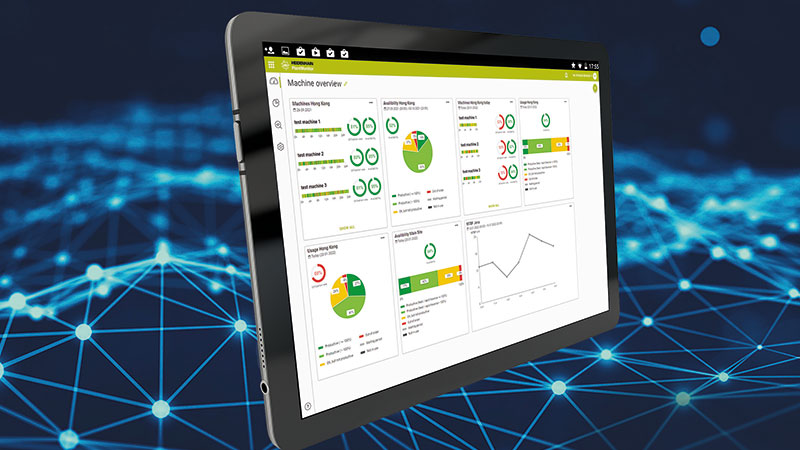

HEIDENHAIN has created a way for multiple instances of StateMonitor to be analyzed: the new PlantMonitor software. This solution networks machines across separate buildings and production sites, giving users greater ability to react to changes and implementing long-lasting optimization. PlantMonitor does this by displaying and analyzing data from different instances of StateMonitor in real time. And as with all solutions from HEIDENHAIN, the user’s data sovereignty is paramount. Users enjoy full control over their data and its usage.
Collect, analyze and visualize machine data with the StateMonitor software solution from the HEIDENHAIN Digital Shop Floor: machines can be monitored from anywhere and at all times.
The PlantMonitor solution from the HEIDENHAIN Digital Shop Floor connects multiple instances of StateMonitor, delivering process transparency across separate production departments and sites.
