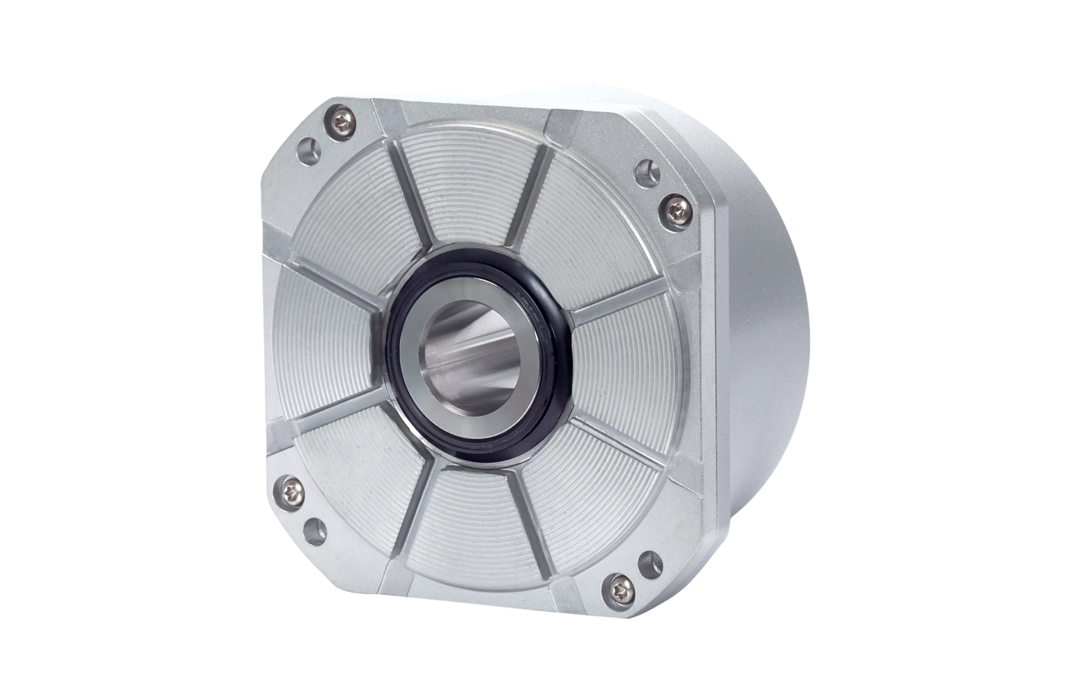

RON 200 series
Incremental angle encoders with a compact design
  • System accuracy of ±2.5” / ±5”
  • Integrated stator coupling
  • Hollow through shaft with ∅ 20 mm­
  • Signal periods per revolution: up to 180 000 with integrated interpolation
  • Interfaces: TTL, 1 VPP
An RON 200 angle encoder with a hollow shaft, a round housing, and a quadradic mounting flange with four mounting holes.
The RON 200 series angle encoders feature an integrated stator coupling that easily connects the measured shaft directly to the shaft of the angle encoder.
High accuracy
Thanks to their high line count of 18,000 lines, the RON 200 series angle encoders can transmit either sinusoidal output signals or square-wave signals additionally interpolated within the encoder.
