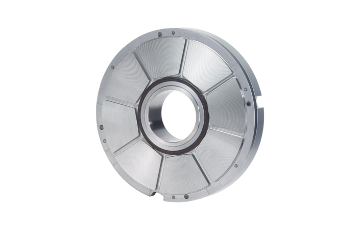

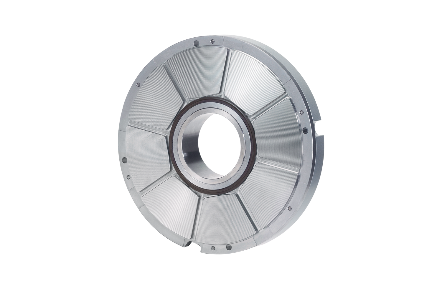

RON 785, RON 786, RON 886, and RPN 886
Incremental angle encoders with high system accuracy
  • System accuracy of ±1” / ±2”
  • Integrated stator coupling
  • Hollow through shaft with ∅ 50 mm / ∅ 60 mm
  • Signal periods per revolution: up to 180 000
  • Interface: 1 VPP
The integrated stator coupling allows the measured shaft to be directly connected to the shaft of the angle encoder on the RON 785, RON 786, RON 886, and RPN 886 angle encoders.
High accuracy
The RON 785, RON 786, RON 886, and RPN 886 angle encoders feature a line count of up to 90,000 lines, very high system accuracies, and sinusoidal output signals.
