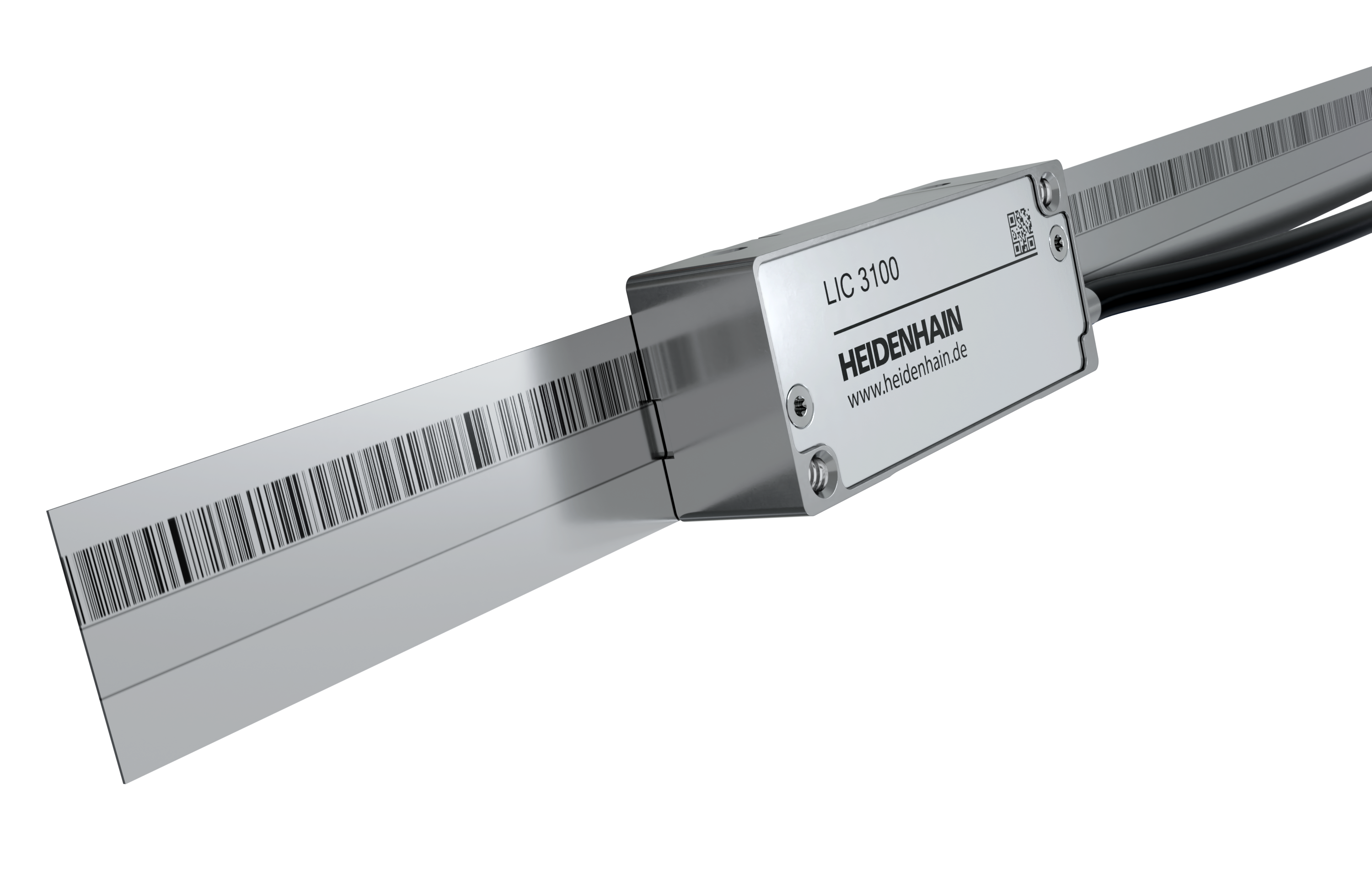

LIC 3100 series
Absolute linear encoders with high accuracy
  • For linear axes with high traversing speeds
  • Measuring lengths of up to 10 m
  • Small measuring step of 10 nm
  • Interpolation error: ±100 nm
  • Various mounting options
  • Interfaces: EnDat, Fanuc, Mitsubishi, Panasonic, and Yaskawa
Long measuring lengths
The linear encoders of this series come in various versions with measuring lengths of up to 10 m. These encoders deliver excellent dynamic behavior, high reliability, and consistently high accuracy over the entire measuring length.
High traversing speeds
Along with high accuracy, the LIC linear encoders feature very high traversing speeds. Measuring steps of just 10 nm and traversing speeds of up to 600 m/min are possible. Position measurement is absolute and, thanks to high contamination resistance, very reliable.
Application versatility
This series can be used in a wide variety of applications. The LIC 3100 series encoders are tough and accurate, enabling high speeds and long measuring lengths.
Resistant to contamination
Thanks to a large scanning field, the encoders of this series are highly resistant to contamination. Localized impurities on the measuring standard have minimal effect on the signal quality and measurement reliability.
