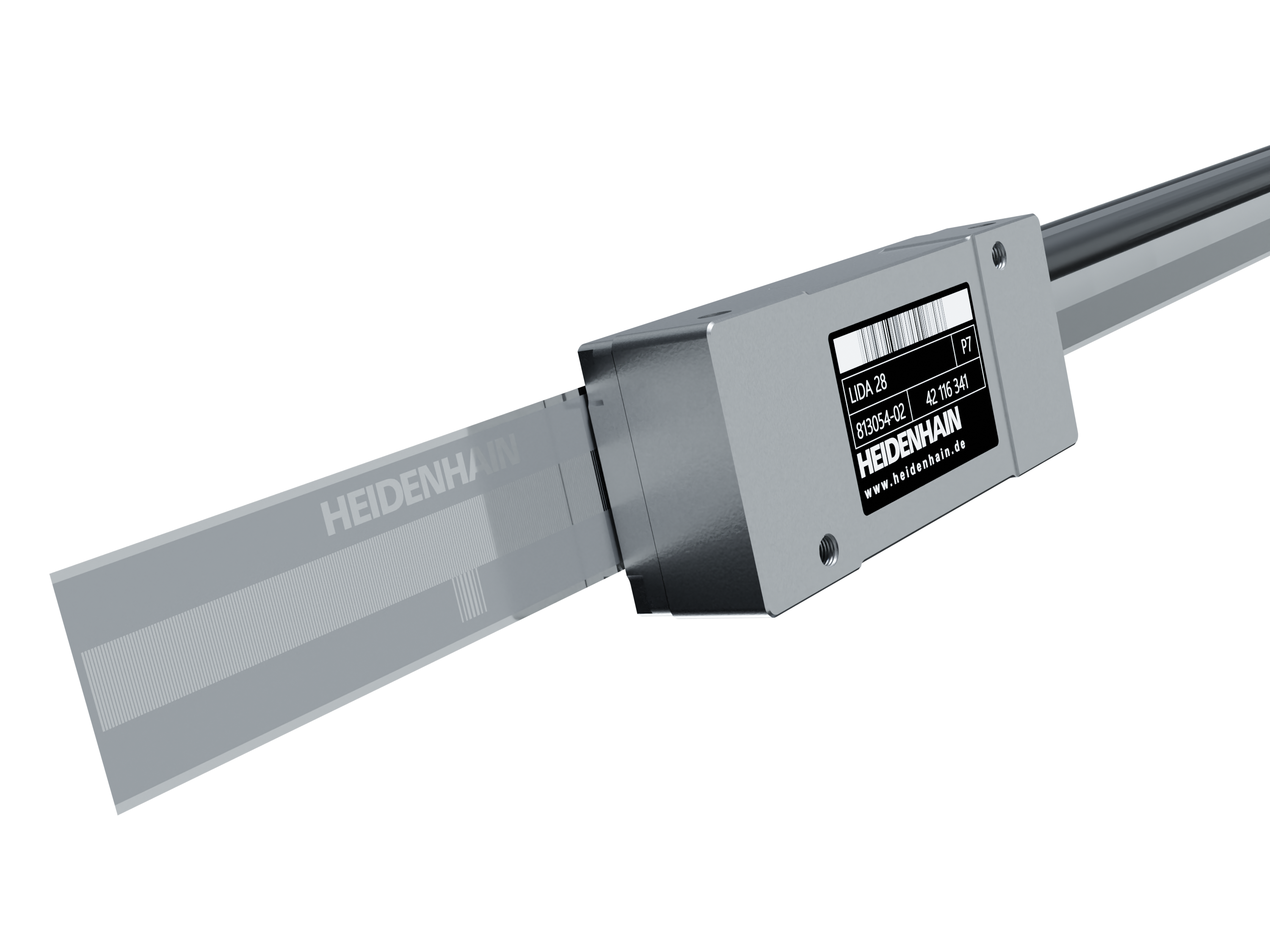

LIDA 200 series
Incremental linear encoder with high accuracy
  • For linear axes with high traversing speeds
  • Measuring lengths of up to 10 m
  • Various mounting options
  • Cut-to-length scale tape
  • Resistant to contamination
  • Integrated signal-quality indicator with three-color LED
  • Interfaces: 1 VPP, TTL
Long measuring lengths
The linear encoders of this series come in various versions with measuring lengths of up to 10 m. These encoders deliver excellent dynamic behavior, high reliability, and consistently high accuracy across the entire measuring length.
Easy installation
The wide mounting tolerances of the exposed linear encoders from HEIDENHAIN have only a minimal effect on the output signals, thus enabling fast and easy mounting. The mounting area on the machine requires only a simple mechanical design.
Signal-quality indicator
An integrated multi-colored LED in the scanning head delivers immediate information about the scanning signals and reference mark signal, permitting fast functionality checks and reliable assessment at any time without extra aids.
Consistently high signal quality
The HSP 1.0 ASIC developed by HEIDENHAIN ensures consistently high scanning signal quality. The ASIC compensates for a drop in signal amplitude by increasing the LED current, thus maintaining the optimal signal shape under contamination.
