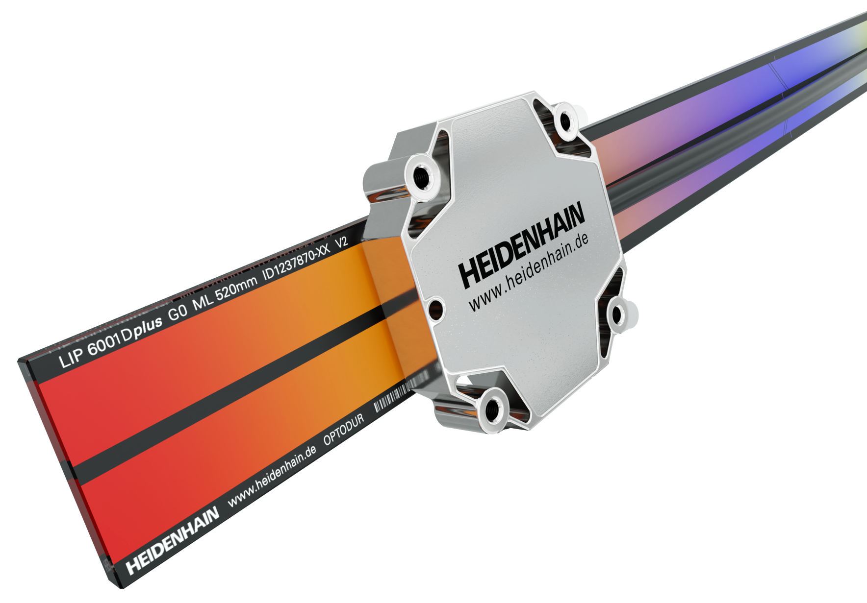

An LIP 6000 Dplus open linear encoder with a two-track spar scale and a wide, low-profile readhead.

This scale contains two separate graduation tracks with diagonal graduation lines oriented at ±45°. This design allows a secondary measurement axis to be captured across the entire primary measuring length.

The two separate graduation tracks on the Dplus scale allow up to three degrees of freedom to be measured when two scanning heads are used. This technology makes it possible to implement complex measuring tasks with a simple and compact encoder design.
