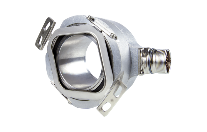

ERN 100 series
Incremental rotary encoders with integral bearing
  • Very high axial tolerance of up to ±1.5 mm
  • Hollow through shaft in up to Ø 50 mm
  • Positioning accuracy of down to ±16"
  • Interfaces: 1 VPP, TTL, and HTL
  • Housing diameter ≈ 87 mm
Wide variety of interfaces
The rotary encoders of this series are available with various interfaces, allowing them to be connected directly to most subsequent electronics. Neither an adapter nor a signal converter is necessary.
Direct shaft coupling
The encoder's hollow shaft allows it to be directly coupled to the mating shaft. No additional rotor coupling is required. The high rigidity permits higher control-loop bandwidths while significantly reducing inaccuracy and installation complexity.
Flexible coupling
The stator coupling compensates for play between the motor and the rotary encoder, thereby correcting inaccuracy. Even tilt and axial play of up to ±1.5 mm can be reliably compensated for. The stator coupling also facilitates easy mounting to the plane surface.
Proven standard
The rotary encoders of this series boast high reliability and perfected technology in a robust design. For decades, they have proven themselves around the world in great numbers within elevators, printing machines, and machine tools.
