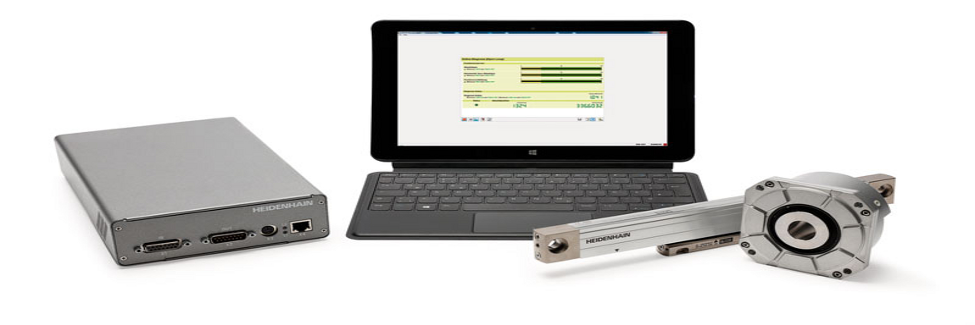

The PWT 100 was designed to be used portably for the functional testing of HEIDENHAIN encoders on-site in production machines and facilities. For this purpose, it features a compact and rugged design with an integrated 4.3-inch touchscreen. The PWT 100 is the successor of the PWT 10, PWT 17, and PWT 18 series, yet offers significantly greater functionality, which is continually being extended through firmware updates.
PWM 21: the inspection unit with especially tight measuring tolerances
The PWM 21 features particularly low measuring tolerances, the ability to be calibrated, and a very wide range of functions. Beyond being used for the commissioning and functional testing of encoders, the unit can also be utilized for diagnostics in a closed control loop. In conjunction with the ATS software, the PWM 21 is a complete adjustment and testing package. Its functionality includes a connection dialog, extensive position displays, diagnostic functions, assistance for mounting and testing, and the display and alteration of memory contents.
