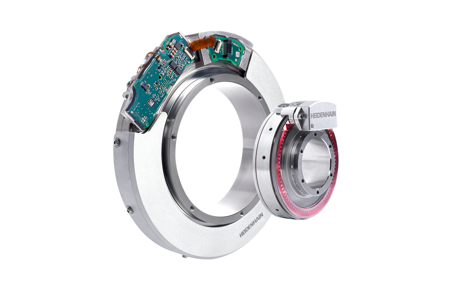

An MRP angle encoder module seen from the front and back, showing the scale, mounted readhead, bearing assembly, and PCB.
