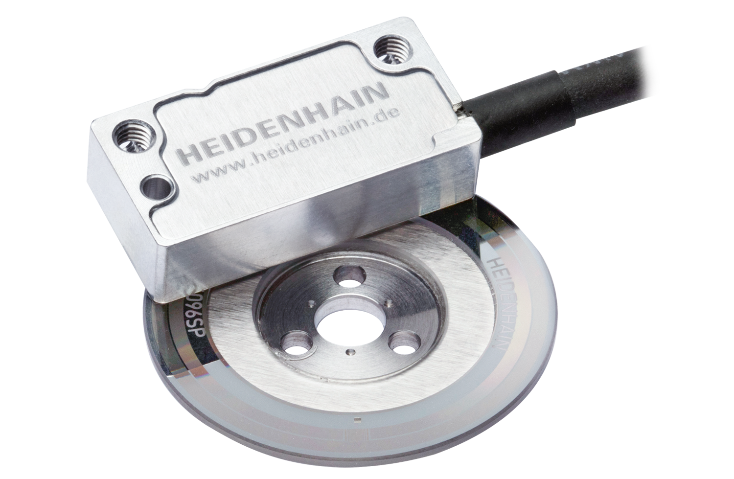

ERO 2000 series
Incremental optical angle encoders with high resolution and accuracy
  • High resolution and accuracy
  • Low mass and low mass moment of inertia
  • Graduation accuracy: ±8” / ±10”
  • Signal periods: 4096 / 2500
  • Hub inside diameter: 5 mm
  • Interface: 1 VPP
An ERO 2000 angle encoder with a metal hub surrounded by a glass disc scale being scanned by a readhead.
Lightweight and compact
The ERO 2000 series angle encoders have a low mass and low mass moment of inertia, making them particularly well suited for dynamic applications with high accelerations.
Versatile mounting options
Encoder installation is made easier by different scanning head versions featuring left or right and straight or angled cable outlets. This provides maximum flexibility for mounting the ERO 2000.
Consistent signal quality
The HSP 1.0 ASIC developed by HEIDENHAIN ensures consistently high scanning signal quality. The ASIC compensates for a drop in signal amplitude by increasing the LED current, maintaining the optimal signal shape under contamination. Noise is also kept uniformly low.
Easy installation
The ERO 2000 series angle encoders are particularly easy to install thanks to their wide mounting tolerances, within which the quality of the output signals is barely affected.
Modular angle encoders consist of a circular scale and a scanning head. Please select these two components from the lists. For further information, please contact our Sales department by phone or e-mail, or through our contact form.
