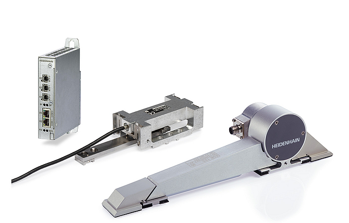

The bed plate supports the main mechanical components (generator and gearbox) and joins the rotor to the tower. As such, it is subject to numerous complex loads. The ESR and ESL sensors can measure the relative motion between components and provide information about wear and fatigue. This enables adaptive control of the wind turbine for load optimization, which minimizes costly breakdowns.

  • Compact system design thanks to EnDat 3 bus operation
Practical design
  • Long-term sensing stability with high resolution and a wide measuring range
  • High level of mechanical and electrical protection for the sensors, electronics and connecting technology
  • Maintenance-free components
