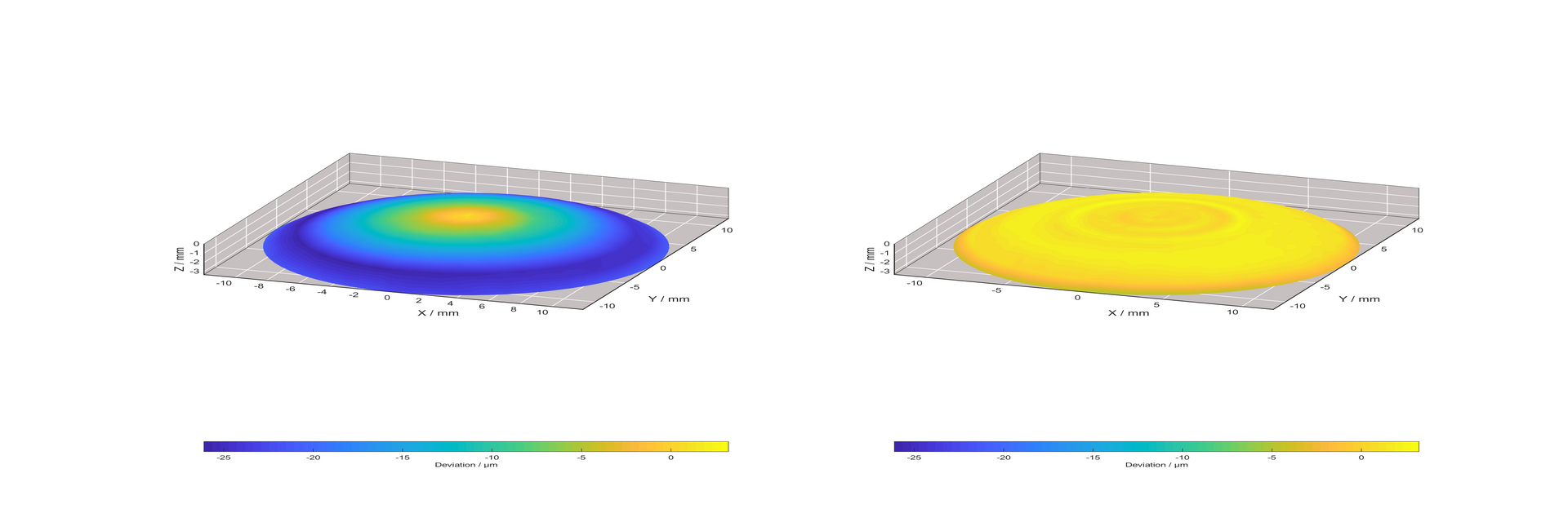

The example of machining an aspheric lens with a diameter of 20 mm very clearly shows the effectiveness of 3D-ToolComp. After the test cut, a touch probe uses Cycle 444 PROBING IN 3-D to ascertain significant deviations of up to 25 µm from the desired shape of the lens. After using 3D-ToolComp to compensate for the radius deviations, the form deviations over the entire surface of the aspheric lens are under 5 µm. For the contact point to be determined with precision, the NC program must be generated with surface-normal blocks (LN blocks) by the CAM system. These surface-normal blocks define the tool position and the contact point on the workpiece, and optionally specify the tool orientation relative to the workpiece surface. The TNC-controlled machine tool automatically performs the compensation.
