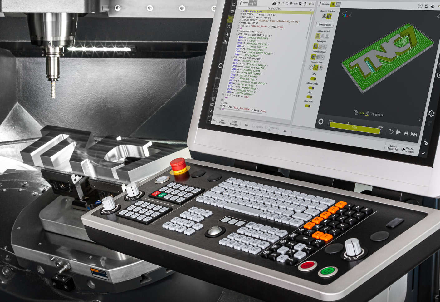

Not every user wants to use a touchscreen. In fact, experienced TNC experts are often accustomed to the HEIDENHAIN keyboard. Of course, the TNC7 is also available with an operating panel. Starting with EMO 2023, there are even three different models. A 16-inch and 19-inch variant are now joining the original 24-inch version. All models feature the same full-HD screen resolution. As an alternative to the large operating panel, customers who choose one of the more compact models can opt for a smaller panel containing the most essential TNC function keys. The 16-inch variant, named the TNC7 basic, rounds out the TNC7 portfolio at the lower end of the spectrum, both in terms of size and functionality. stepping up as the successor to the TNC 620 for 3+2-axis machines but with all of the characteristic benefits of the TNC7.

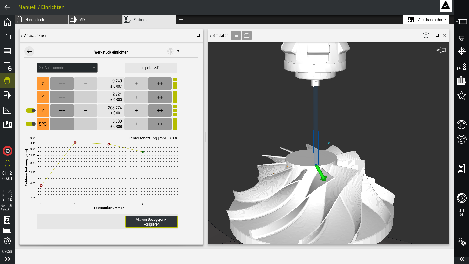

The quest for high first-part efficiency across all batch sizes and levels of automation requires looking beyond merely the machining phase. Machine setup, as well, needs to be fast and convenient. Faster setups cut down on non-productive time and reduce a company’s carbon footprint. With its graphically supported functions for 6D workholding and workpiece setup, the TNC7 offers two major time and energy savers. This virtual support enables fast, user-friendly and reliable position probing for both fixtures and blanks, regardless of the setup’s complexity. Even for clamping towers or multiple parts clamped in a row, the TNC7 provides interactive step-by-step support throughout the setup process for simple and complex parts alike. In the case of complex parts, setup with the 6D setup function can be up to five times faster than with conventional probing cycles. When applied to workholding, this 6D position probing feature is part of the enhanced dynamic collision monitoring (DCM v2) function. When applied to workpieces, the new Model Aided Setup (MAS) option comes into play.

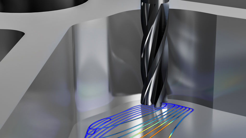

The package of options available for the TNC7 includes Optimized Contour Milling (OCM), which delivers next-generation trochoidal milling by automatically calculating the best trochoidal milling strategy at all times for pockets and islands of any shape. Users simply enter the contours and apply the optimal machining parameters from the built-in cutting data calculator. As a result, roughing and milling become highly productive and impose less wear on tools. OCM’s intelligent deburring function then implements perfect edges along the programmed contour. Optimized Contour Milling reduces energy consumption, raises process reliability and saves time throughout the production process, from programming to machining.

Three screen sizes, two performance levels, and alternative keyboards: EMO 2023 marks the expansion of the TNC7 HMI portfolio from HEIDENHAIN.
The new graphical 6D workpiece setup function for the TNC7 helps the operator dial in workpieces, and perfectly complements the control’s graphical setup support for workholding.
OCM, the next generation of trochoidal milling from HEIDENHAIN, uses the full cutting edge of the milling tool for maximum removal rates during the machining of any islands and pockets. This significantly reduces the machining time and the amount of to
