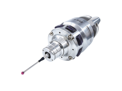

TS 640 and TS 642
  • Infrared signal transmission
  • Interface: HTL
  • Probing speed: 3 m/min
  • Dust-proof and water-resistant

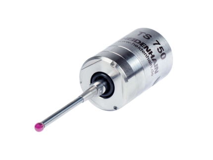

TS 150 and TS 750
  • Compact dimensions: 25 mm in diameter
  • Probing repeatability of down to 2 σ ≤ 0.25 µm
  • Signal transmission via cable
  • Interface: HTL
  • Probing speed: 3 m/min (with the TS 750: 1 m/min)
